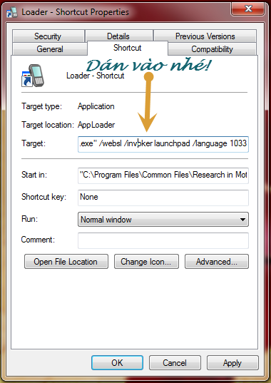

5. Uprom Update Software bằng Loader.exe
(CÁCH NÀY TỔNG HỢP LẠI TỪ BẢI CỦA BẠN @ResearchInMotion TRÊN BBVIETNAM)
